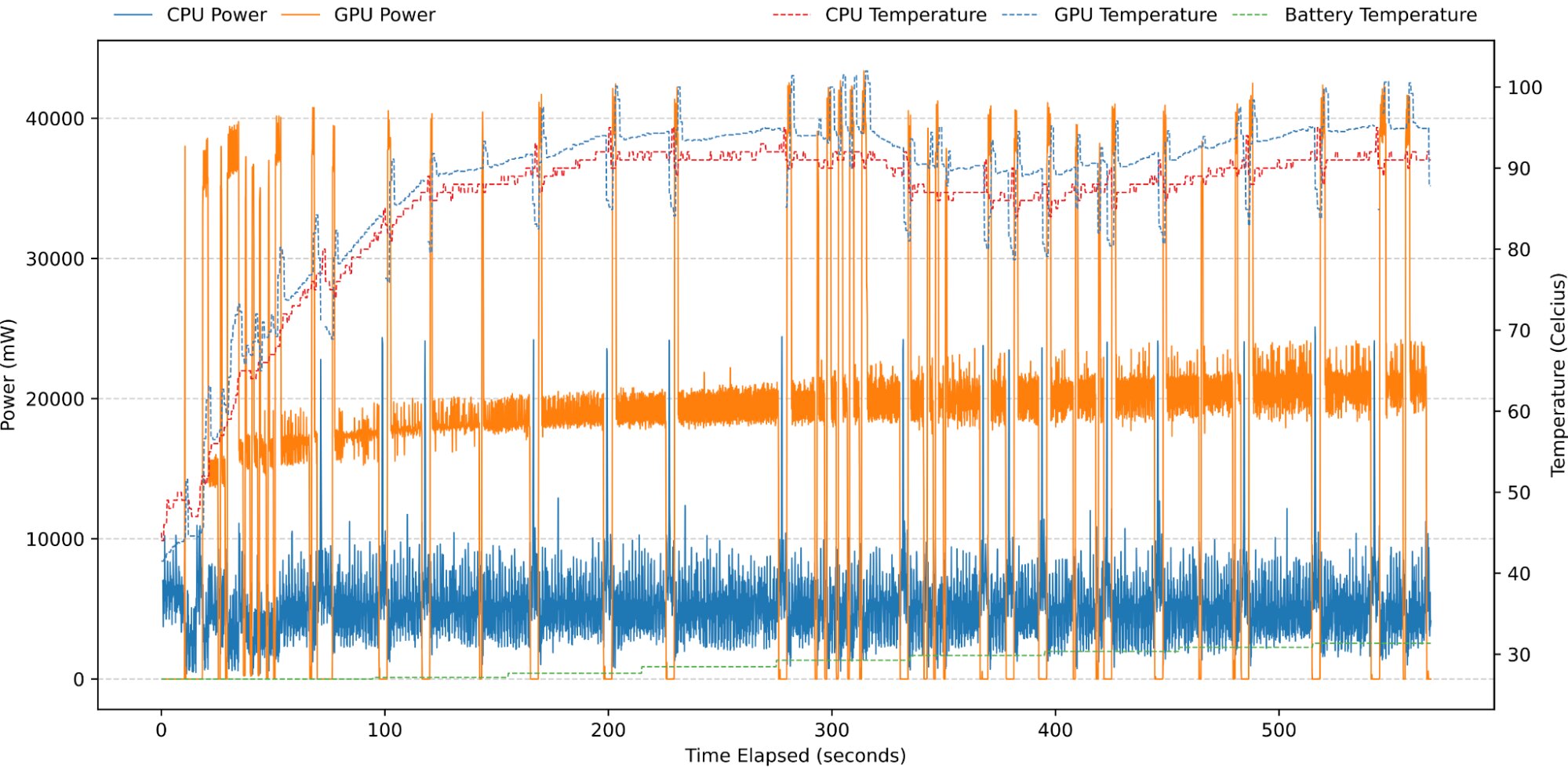

Figure 1: Power draw and temperature across a single coding task on an Apple M1 Max, powered by Qwen3-Coder-30B-A3B. Each power spike corresponds to a new LLM inference call; the sustained thermal load above 90°C reflects the cumulative cost of 30+ calls over roughly 10 minutes, much of it potentially wasted on a task the agent will never complete.
While testing these interactions on a MacBook Pro M1 Max (as shown in Figure 1), a single coding task could:
  • Last over 10 minutes
  • Trigger 30+ separate LLM inference calls
  • Push GPU power draw past 40 watts
  • Sustain GPU temperatures above 90°C for extended periods
That’s not a quick query, that’s your laptop working as hard as possible, for ten minutes straight, on a task that may ultimately fail.
For context, a single failed coding task can drain roughly 3% of a laptop’s entire battery. That might sound small, but consider what it means in practice. If you’re running an agent to help debug a complex piece of software, it might fail five or ten times before finding a working solution, or give up entirely. Those failed attempts alone could cost 15-30% of your battery, before you’ve even seen a useful result.
