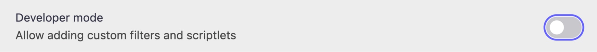

  3. Scroll down and enable Developer mode.
Enabling 'Developer mode' in Brave's Shields Settings

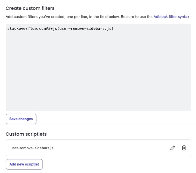

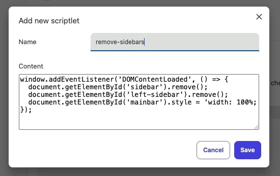

  1. Under Custom scriptlets, click Add new scriptlet and write your JavaScript. Give it a name (note that the custom scriptlet always gets saved with a user- prefix). Then click Save.
Customize a website's appearance with custom scriptlets
  1. Finally, insert the rule by adding a custom rule for the website you want to modify, and press Save changes. Note that you must use filter rule syntax, which looks something like “example.com##+js(name-of-your-scriptlet.js)”. For more information, see the custom scriptlet technical documentation.
Creating a custom filter rule

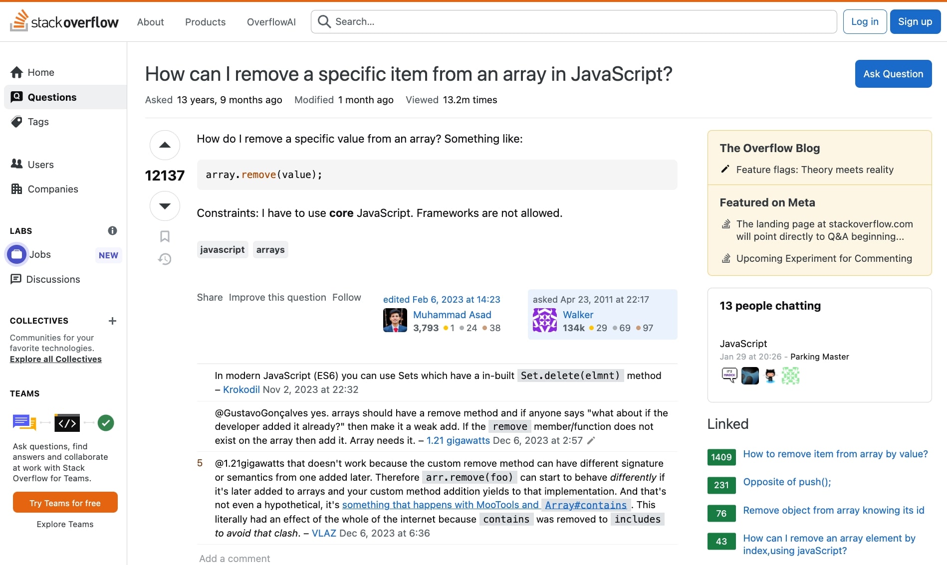

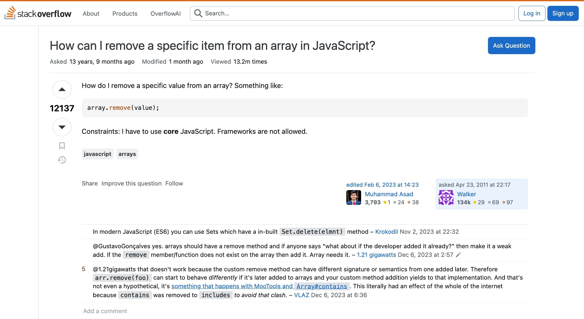

Once the scriptlet is done, you can visit the website you just modified to see the difference:
Before: stackoverflow.com without the custom scriptlet
After: cleaned up stackoverflow.com with the custom scriptlet which removed the sidebars
