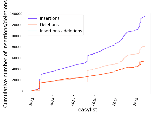

Growth of EasyList Over Time
EasyList is large, and has been growing since its start. We measured the number of rules added to, and removed from, EasyList, by the EasyList maintainers, since 2013. As the above graph shows, EasyList has year-on-year added more rules than it removed, suggesting an increasing cost of applying EasyList for filtering.
For the most part, the graph shows a constant and smooth trend upwards in both the number of new rules added and the number of rules removed. The number of new rules consistently outpaces the number of rules removed.
There are two exceptions to this trend though, one in early 2013, and another in late 2015. In early 2013, Fanboy’s list (another popular filter list) was merged with EasyList, causing a sharp change in EasyList’s makeup. The sharp change in mid-2015 appears to have been the result of a short term error or re-organization on the part of the list maintainers, since there were a large number of changes, but no significant variation in rules in the list.
