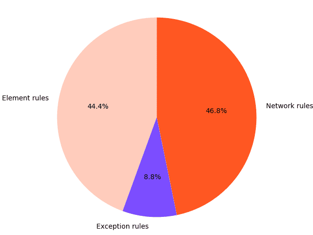

EasyList is very large, consisting of approximately 70k rules at the time of this writing. About 35k are network rules, 30k are element rules, and 5k are exception rules.

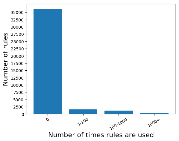

As a result, we successfully crawled 8,085 domains, and 30,280 individual pages. We found that the vast majority of EasyList rules are not used when browsing popular websites; 3,268 of 39,198 (~8%) of network and exception rules were used during our crawls (these measurements exclude element rules).

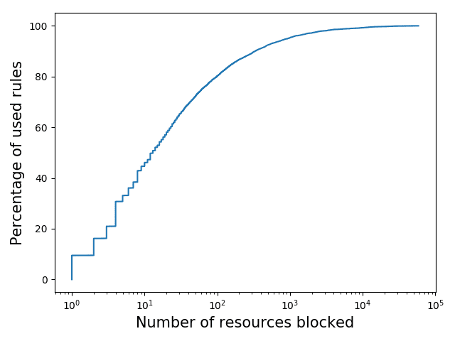

We also found that the rules in EasyList were not equally useful, even when only considering the rules that were used at least once. For example, we found that only 201 rules accounted for 90% of blocking activity. In fact, 99.5% of rules were used 10 times or less on the ~30k pages we visited.
