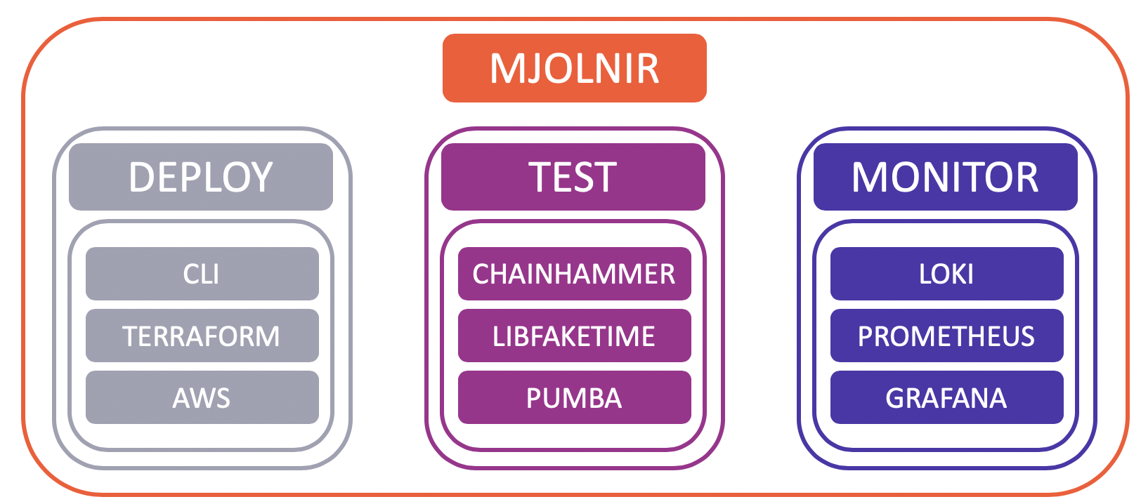

Mjolnir: System Design
The Mjolnir system can be grouped into three components (Figure 1): (1) the deployment, (2) testing, and (3) monitoring components. Each component is divided into subcomponents, so let’s dive into each of them:
![](/static-assets/images/optimized/blog/mjolnir-tooling-for-bat-apollo/images/mjolnir-component-overview.png)
Figure 1. Overview of Mjolnir’s components
Component 1: Deploy
These components help configure, validate, and build the nodes. They leverage Terraform and Amazon Web Services and bundle all functionality in a CLI. Let’s see what each of the subcomponents do:

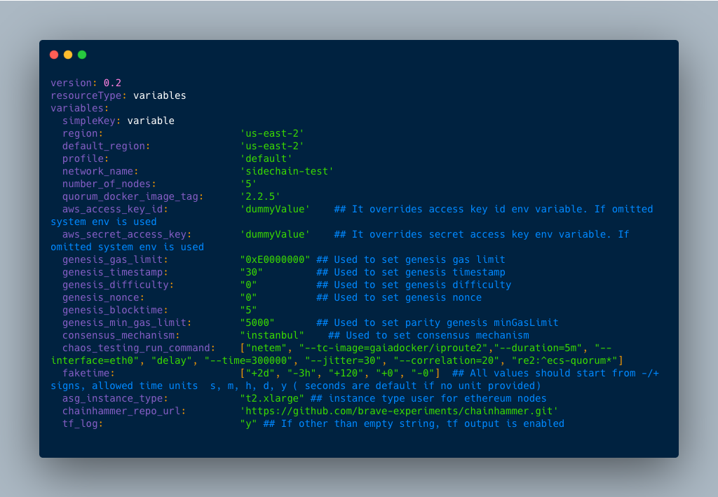

CLI: The CLI provides a user-friendly entry point to the Mjolnir toolkit. The user needs only to update a YAML file with their desired settings and execute a subcommand with the YAML file. The CLI instructs Terraform to deploy the requisite infrastructure to the target environment, which in our case is AWS. In addition to this, it also acts as a management console for the cluster.
![](/static-assets/images/optimized/blog/mjolnir-tooling-for-bat-apollo/images/sample-config.png)
Figure 2. Sample Configuration File
Terraform: Terraform is a tool for declaratively managing cloud-based infrastructure and service by way of the Infrastructure as Code paradigm. Being declarative means that it builds according to a target state, making it easier to reason about the codebase.
Amazon Web Services (AWS): As mentioned above, our target environment is AWS. Services currently employed include (but are not limited to):
- Elastic Container Service (ECS): ECS is a fully managed containerisation service. While one could argue that we take a performance hit by not choosing to go barebones, we run the service in EC2 mode which allows for some optimizations, while still affording the benefits of a managed service. The nodes in the network are deployed to ECS.
- Simple Queue Service (SQS): A fully managed message queueing service that allows the decoupling of services and scaling of architecture. In our setup, nodes are laid out as microservices. This allowed us to pass different runtime parameters to our containers (i.e. clock skew, chaos testing)
- Simple Storage Service (S3): This provided both ephemeral and long term storage to the clusters. Ephemeral storage was important when bringing up the service as declarative languages do not readily lend themselves to programmability. Given the above, s3 was a good staging area.
Component 2: Test
These components are responsible for initiating and collecting results on the tests suite. They include Chain hammer, libfaketime and pumba:
Chain hammer: This is a collection of python scripts that rapidly sends asynchronous transactions to an Ethereum node.
libfaketime: This library allows us to intercept system calls made within the containers and return values modified by the user. With this, we were able to simulate clock skew between the containers.
Pumba: This is a tool for Chaos testing and network emulation within containers. While it’s functionality doesn’t quite match Netflix’s Chaos Monkey, we found it suitable for simulating both partial synchrony and asynchrony within the containers running the Ethereum nodes.
Component 3: Monitor
The monitoring component collects and shows data from the tests.
Grafana: Collects time series data and presents it in dashboards which help to visualize and analyze how the Ethereum nodes perform over time. The dashboards enable us to understand any exceptional node and network behaviour.
Loki/Prometheus: We use log aggregation systems which are responsible for steaming logs and metrics from the ECS instances to Grafana.

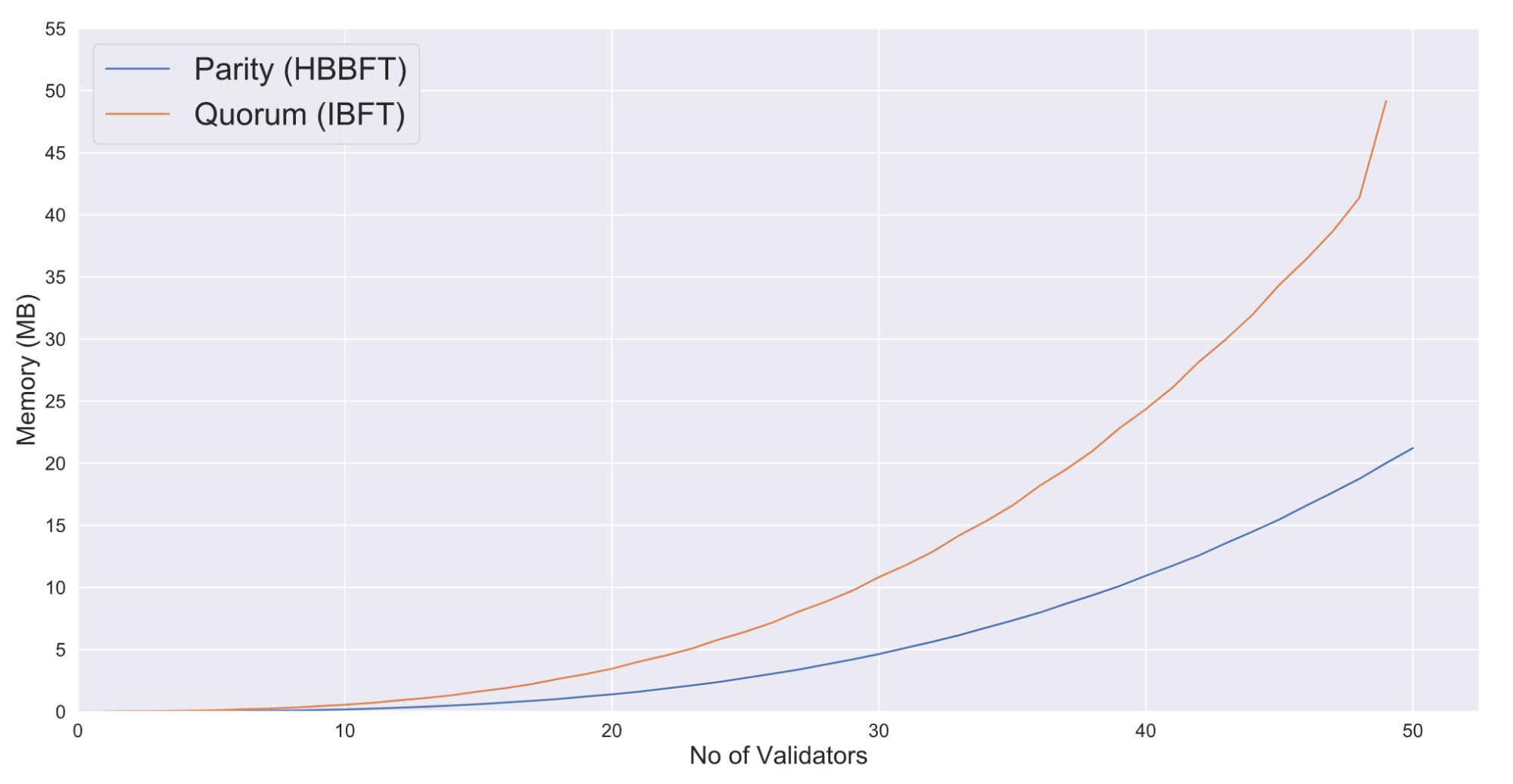

Memory Utilization
We measure the increase in the memory consumption of the clients as we increase the number of nodes in the consortium. This is a proxy for communication complexity, as we imagine that the nodes have to do more work to broadcast messages.
![](/static-assets/images/optimized/blog/mjolnir-tooling-for-bat-apollo/images/parity-quorum-chart.png)
Client | Quorum | HBBFT |
Result | Quorum seems to perform worse. As can be seen from the graph, its memory consumption is “more than quadratic” for every new node added to the consortium. | Parity seems to scale quadratically with regards to both communication and memory costs. |

- HBBFT consumes less memory for every new node added to the network.
